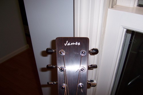

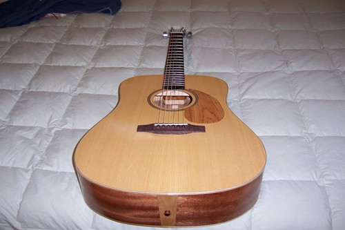

   Someone let me know if these show up.
                James W B
James W Bolan
Nashville Tennessee
PostPosted: Wed Jul 12, 2006 11:03 am

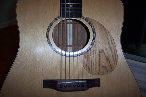

Wow...nice. Love that pickguard. Did you make that?

Hey It worked. I`ll try 1 More

Maybe some explaining would help.I own my own small construction company . I had some left over maple from a cabinet job I used for bindings and End graft and that cute little diamond as my wife calls it.The pick guard is a piece of Tennessee Hickory I also had left over from another cabinet job.It seemed fitting since I`m a hillbilly from Nashville.I`d like opinions on the pick guard ,but be honest.My wife really likes it ,she says it gives it a real woody look.I thought maybe to much grain.Any way there it is.I really appreciate all you folks on this forum who are so willing to help.I know I`ve got a long ways to go to get to your standards. But hey I really had a Spectacular time building this guitar.A true labor of love. James W B

Thanks Bill.I actually made 2 pickguards from that piece of Hickory.The other one doesn`t have as much grain.I actually liked it better but momma said no way.And when mommas happy, you know the rest .           ;    James W B

Very nice, James! Yeah, the guard looks good as it is, but I think it would have been a little better without that bit of "cathedral" grain at one end, or maybe with more of it along the whole guard. But don't get me wrong--it still looks great! You also did a nice job of shaping it around your rosette.
In your photo it looks like the body is a bit more shallow than a traditional dreadnaught. Is it?
BTW, if you hit "enter" between each photo post, it won't scroll the page to the right.

Nice job on the headstock inlay too.
Is that an Allied rosette?

Very nice guitar, first or not! The woody look on the pg is nice, though personally, I'd opt for less grain.

Thanks guys I really appreciate it.To Carlton,the body is the minimum dimensions the plan gives for a dread.I have a om cutaway that I`ve had since the 80`s that I`m used to playing And of course the body is quite a bit smaller, so I didn`t want to build too large.To Kirt,the rosette came from LMI.To Burbank,I`m with you on the pickguard but momma said.And yes I truly am amazed by the sound.I can`t put this guitar down.Thanks again James W B
